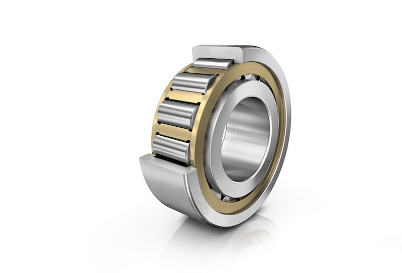

With the new cylindrical roller bearings of series NJ23-ILR, Schaeffler is introducing a series of rolling bearings for heavy-duty industrial gearboxes and construction machinery. The bearings feature a compact design, are equipped with the high-performance MPAX cage, and have a very high dynamic load capacity. The load rating has been increased by an average of 24 per cent, thus doubling the operating life compared to the NJ23 basic type. The new NJ23-ILR bearings therefore take a top spot among the cylindrical roller bearings for heavy-duty applications that are available on the market. They perform better than commonly available bearings of the same basic type, even under mixed friction conditions due to insufficient lubrication. The replacement of NJ23-ILR bearings at the end of the lifecycle is carried out in accordance with DIN 5412-1. Users from the industrial and offroad segments now have a sustainable, reliable and convenient-to-use rolling bearing solution for highly loaded shafts. This solution impresses due to its durability and makes a valuable contribution to reducing CO2 emissions.
The new cylindrical roller bearings of series NJ23-ILR have a very high dynamic load carrying capacity. They therefore take a top spot among the cylindrical roller bearings for heavy-duty applications that are available on the market.

“Our new cylindrical roller bearing series was specifically adapted to match these increased performance requirements through optimisations in the selection of materials, design, surface quality and heat treatment,” says Sebastian Pfeuffer, Product Manager Cylindrical Roller Bearings at Schaeffler. “The high-performance MPAX cage with its proven strength characteristics also stands for far above-average load carrying capacity and has proved to be extremely robust in high-vibration applications, for example. The rings and rollers can also be supplied with a Durotect-B coating to provide increased anti-wear protection.”
The cylindrical roller bearings of the new NJ23-ILR series are available from the first quarter of 2024 with bore codes 16 to 44 and from Q4/2024 with bore codes 48 to 60. The bearings in the size range up to bore code 36 already have the X-life quality seal for a longer operating life, higher load carrying capacity, and a compact design.
