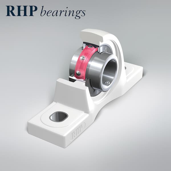

NSK’s Life-Lube® bearing units are proving increasingly popular in the food and beverage industry, and with good reason. These advanced bearings combine the corrosion-resistant properties of Silver-Lube® housings with the excellent sealing and lubricating properties of Molded-Oil inserts. Life-Lube® units are specifically for use in sectors where contact with water and process fluids is unavoidable, and where excellent chemical resistance and long lubrication life are primary requirements. By taking advantage of the benefits available, food and beverage plants can tap into considerable savings from reduced downtime and maintenance costs.
Astute design engineering means Life-Lube® bearing units (comprising a housing and bearing insert) are adept at withstanding the often harsh operating conditions of food and beverage plants, while simultaneously preventing any contamination of the processing environment to meet strict hygiene regulations.
Corrosion resistance
Primary among the design considerations is the unit’s housing material: thermoplastic polyester (PBT), which is highly resistant to corrosion. In conjunction with Molded-Oil bearing inserts and nitrile rubber seals, this design guarantees good chemical resistance and long service life.
In particular, the polymer housing not only eliminates any risk of contamination from painted or coated surfaces, but its smooth finish prevents dirt adhesion and reduces wash-down time. Complementing the housing is the stainless steel insert, which delivers improved corrosion resistance for wet environments. Moreover, the Molded-Oil insert cavity contains a lifetime of lubricating oil and polyolefin resin that means no re-lubrication is required for the lifetime of the product.
Another important feature for the food and beverage industry is the flinger seal, which prevents the ingress of bacteria and protects the Molded-Oil filled cavity. There is also no potential for lubricant leaks.
Bacteria-free
NSK has taken great care to ensure the design of its Life-Lube® bearing units are free of crevices and ‘bug traps’ that could harbour mould or bacteria. As a result, the bearings are ideal for food manufacturing environments that involve dust (dry or wet), water (spray or submerged) and wet abrasive contamination, as well as temperatures up to 80°C. Life-Lube® bearing units are also suitable for use in some starch-based environments, as well as those involving low temperatures, down to -18°C.
The suitability of Life-Lube® bearing units for food applications is vast, encompassing tasks that include primary (cutting and mixing), secondary (moulding), conveying, inspection, heating and packaging processes, while beverage applications include bottle moulding, filling, sealing, inspection and packing. In these operating environments, Life-Lube® will resist excessive moisture, washdown chemicals and contamination, all while operating at continuous high speeds if required. The speed factor is maximal dn = 12 x 104 ( dn =bore diameter in mm x speed in rpm).
