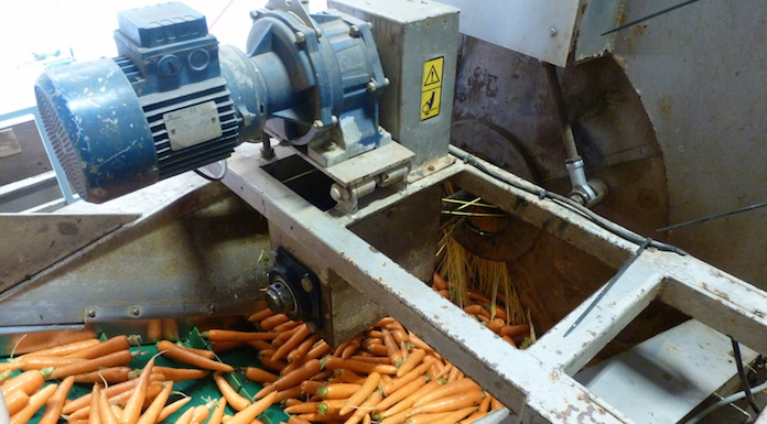

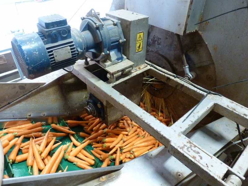

Among a growing number of food plants enjoying the benefits of Life-Lube® bearing units is a premium vegetable processing company. The facility was previously experiencing frequent bearing failures on a high-volume carrot washing line, causing significant downtime and reduced production. The company would often have to change its bearings every six weeks.
A cutaway section of an NSK’s Life-Lube® bearing unit, showing the stainless steel insert
and Molded-Oil lubrication.
NSK performed a bearing failure analysis and application review as part of its AIP Added Value Programme. In particular, NSK conducted a process mapping exercise of the carrot washing operation, identifying problematic areas for the bearings. The analysis revealed that the ingress of hard-particle contamination and washdown fluids were significantly reducing bearing life. In effect, the lubricant of the standard bearings was washing out, leading to premature failures.
The expert team of NSK specialists recommended Life-Lube® bearing units featuring Molded-Oil inserts, with a subsequent trial demonstrating vastly improved bearing life. No failures had occurred after a year of operation. The vegetable processing company is now enjoying significant annual cost savings, with reduced downtime and maintenance, as well as increased productivity.
