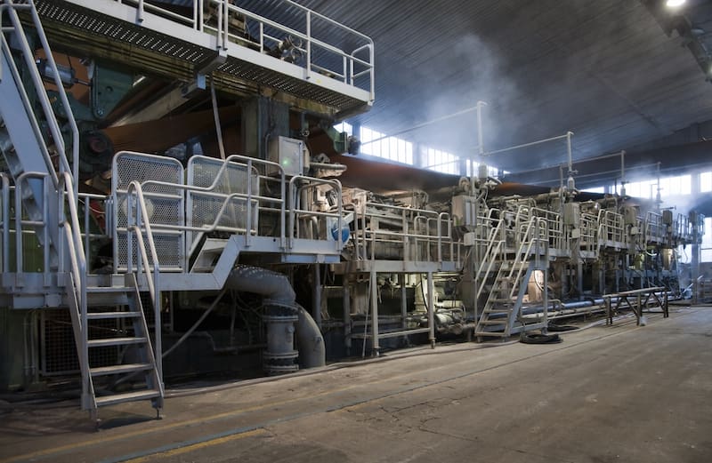

Many sections of papermaking machinery are subject to high temperatures which present specific challenges to bearings. (Photo: Moreno Soppelsa/Shutterstock)
TL series spherical roller bearings are specifically designed for sections of papermaking machinery where elevated temperatures prevail, including dryer rolls, calender rolls, canvas rolls and PV rolls. The bearings were developed as a solution to a specific problem: inner ring fractures. This problem is common on dryer cylinders (including Yankee dryer rolls) and calender rolls, where steam is passed through the hollow axis of the roll to heat it. Here, the journal expands faster than the bearing, making the fit tighter. As the hoop stress (force exerted circumferentially) of the inner ring increases, cracks can begin to appear.
High temperatures in papermaking machinery also present further challenges to bearings. For instance, the presence of heat lowers the viscosity of lubricant, reducing bearing life, while unwanted creep can have a negative impact on dimensional stability.

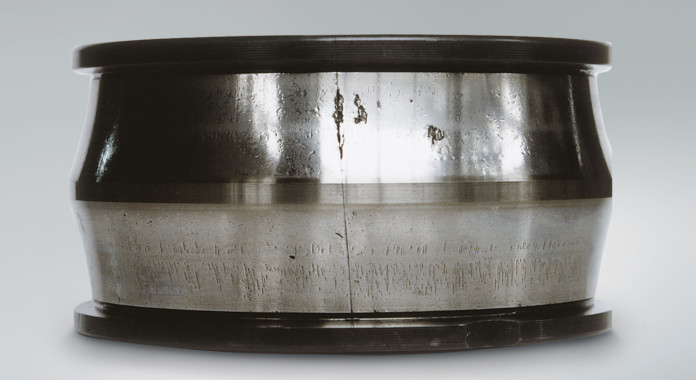

To counter the effects of temperature, NSK analysed the mechanism of inner ring fracture and established a strength evaluation method that subsequently led to the development of the proprietary TL specification. The type of steel used in these bearings is case-carburised using a special method of heat treatment that attains both high raceway surface hardness and dimensional stability under high temperatures. Importantly, the strength of the inner ring is increased sufficiently to better resist hoop stress, even at temperatures up to 200°C.
                   Fracture evident on the through-hardened inner ring of a spherical roller bearing due to hoop stress
The resistance of inner rings that meet the TL specification is higher than the resistance of inner rings made from bainitic steel or bearing steel, while the surface hardness of the rolling surface is greater than the hardness of rolling surfaces made from bainitic steel or case-hardened steel. These factors underpin the ability of TL bearings to provide longer service life when used on calenders, guide rolls and smoothing rolls, for example.
