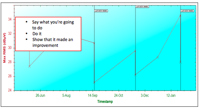

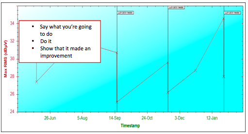

Alternatively, on-condition lubrication using ultrasound provides data which eliminates these three problems by giving the lube tech
- A sound to assess
- Condition Indicators with alarms to measure
- A dynamic history of the health of every bearing in the program
In a Planned maintenance strategy, ultrasound will tell you when to stop injecting grease. In the Predictive strategy, an ultrasound measurement alerts the lube tech when and if lubrication is needed at all. The grease quantity and interval calculations become only guidelines. Measurement of friction using ultrasound is the driving and controlling parameter.
Ultrasound “hears” friction, so the trained lube tech acquires valuable information on the frictional state of that bearing.

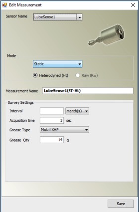

This task is best managed with software. Combining preparation with friction measurement software provides a smooth, seamless integration between the condition assessment and the lubrication function.
A measurement and lubricant database is created for each bearing. The database controls the sensor type, the lubricant type and the calculated maximum quantity.
How much grease does your grease gun dispense? If the answer is, “I don’t know”, then calibrate your grease guns. Minimise variables that cause errors. Ensure that the majority of grease guns used deliver the same amount.
“Patience is a virtue” applies to lubrication. Build in a waiting time between each injection of grease to ensure that the impact of that injection is detectable. This prevents over-lubrication and allows you to spot failures such as blocked and broken grease tubes.
A database Tree and Lube Surveys, similar to ones used for condition assessment, is now created. These surveys, loaded into your ultrasound data collector, guide you to a precise lubrication.
In Survey Mode, the ultrasonic instrument guides the lube tech from point to point and measurement data is the reference to lubricate the bearing. With the reference stored, the detector prompts the technician to begin adding grease. After the waiting time, another measurement dictates the next action.
Planned vs. predictive approach
To assist the lube tech, the ultrasound meter’s built-in algorithms compare each successive reading and suggests the technician either add more grease at a controlled rate, or decide to stop.

The result becomes a history for each bearing with the latest bearing condition data always available to listen to or analyse for the presence of early-stage bearing defects.
It is important to show that this new lubrication strategy is working. That means developing some performance indicators.
The data collector records the number of shots of grease applied during the lube process and the database knows how much grease is in a shot. Calculating grease consumption therefore, becomes a simple task for this software; and the corresponding consumption reports are meaningful and useful. Showing a reduction in grease consumption along with a measurable improvement in machine reliability is a great way to prove that your program is working.
