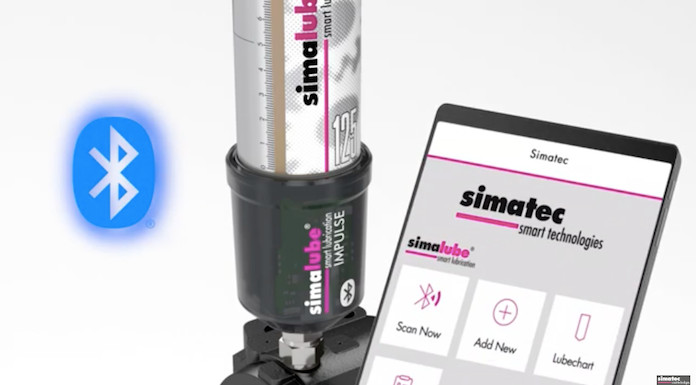

The simalube IMPULSE connect is the latest generation of the pressure booster from the simalube family. The proven functions of the IMPULSE have been supplemented with the option of connecting the device to a smartphone via Bluetooth®. In connection with the newly developed «simatec world of maintenance» app, the devices can be easily configured and then monitored without having to be directly at the lubrication point. Information such as general status, fill level, lubricant, size, start and change date etc. is displayed to the user and easy to read in the app. It also enables the customer to manage the lubrication points digitally.

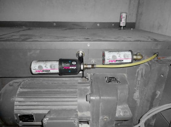

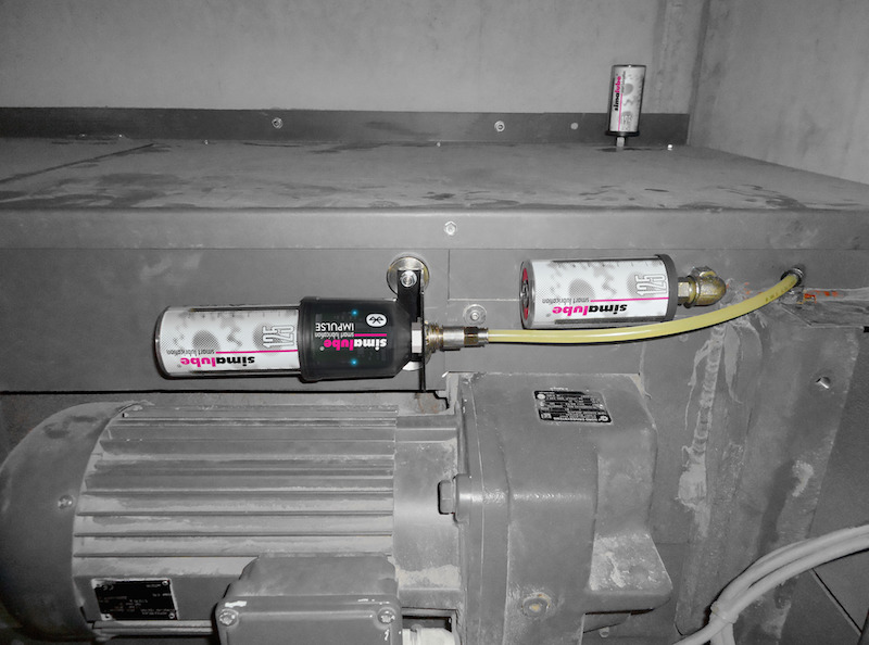

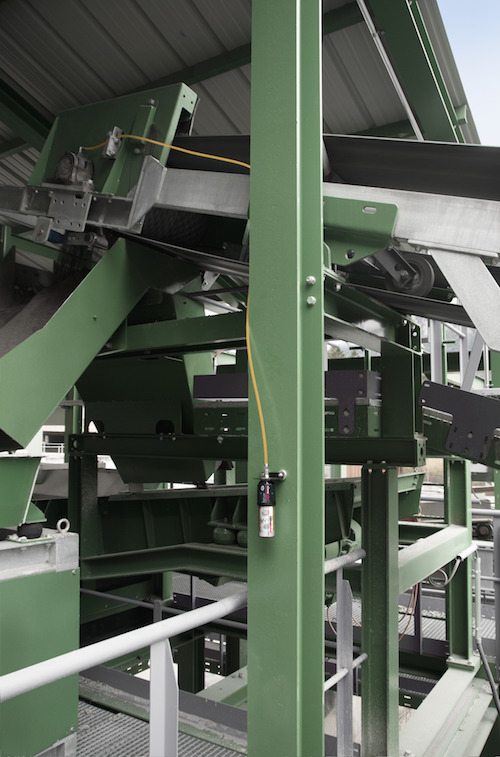

Together with the simalube lubricant dispensers in sizes 60, 125 or 250 ml, the simalube IMPULSE connect ensures reliable lubrication at high counter-pressures and in lubrication lines up to four meters long. Regular lubrication triggers supply the lubrication point with 0.5 ml of oil or grease up to NLGI 2 at a pressure of up to 10 bar. This is gentle on the lubricant, as only the dosing quantity is under pressure. The operating status can be easily monitored with the «simatec world of maintenance» app. The intelligent pressure booster also provides continuous information about the current operating status.
Simple installation and operation
As soon as the battery pack is inserted and the lubricant dispenser screwed in, the simalube IMPULSE connect is operational. The IMPULSE connect is connected to the «simatec world of maintenance» app via Bluetooth. The runtime, the size of the lubricant dispenser and the lubricant can then be selected and saved in the app. The system then works with the settings selected by the customer. When the lubricant dispenser is changed, the simalube IMPULSE connect remains permanently installed on the lubrication point. Only a new battery pack needs to be inserted before a new simalube lubricant dispenser is screwed on. This way, the connection point remains sealed even when the dispenser is changed and no lubricant runs back. The settings saved in the app remain the same, but can be changed if necessary. The new start date is set automatically after the new battery pack is inserted.

The compact design of the simalube IMPULSE connect allows installations in confined spaces and in all positions; even under water. As an IP68 protection class device, the pressure booster is dustproof, waterproof and suitable for use in a wide range of industries. Equipped with a new battery pack at each refilling, the simalube IMPULSE connect can be used for ten dispensing cycles of simalube 125 ml or for up to three years.

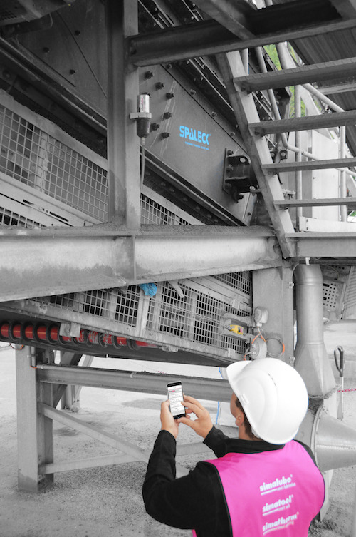

With the «simatec world of maintenance» app, simatec ag has created a platform for easier and more efficient management of lubrication work. The app offers the user the possibility to record lubrication points, to set the necessary parameters for the lubrication and to control or monitor all activities around the lubrication. The simalube IMPULSE connect equipped with Bluetooth® can be configured directly via the app, the current operating status can be viewed from a distance of up to 20 m via the app.
