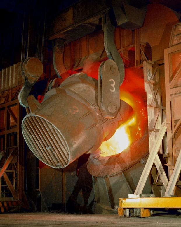

The BOS plant uses two vessels that convert molten iron from the blast furnaces into steel. Each vessel weighs around 1,300 tonnes, supported on two, 1.75m diameter spherical roller (tilt) bearings. Each vessel is able to tilt to various angles up to 150° from the vertical during the process for charging and discharging purposes. The arduous duty generates high local contact loads, which over time, result in surface fretting, pitting and spalling of the race surfaces. Ultimately, if undetected, further degradation can result in roller fractures and consequent catastrophic failure of the tilt bearings.
