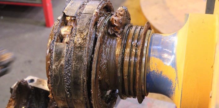

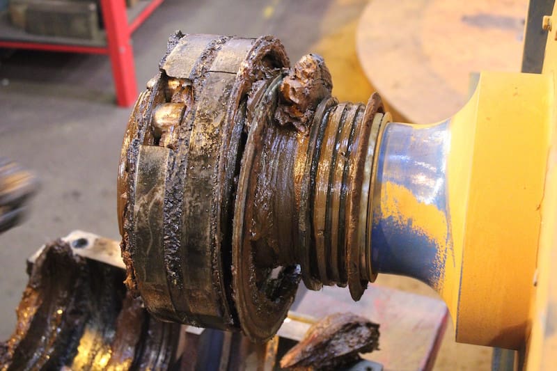

For several decades, conveyor pulley bearing housings were protected from the environment with labyrinth type sealing methods. While there have been iterations over the years, they fundamentally adopt a ‘grease filled torturous path’ approach to sealing.

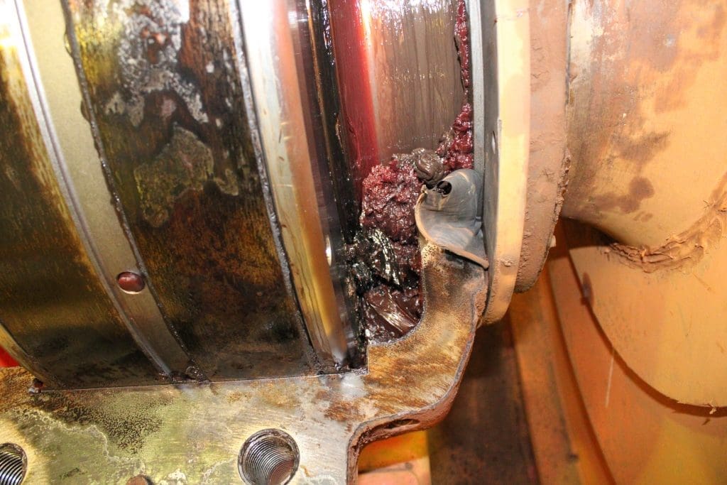

DASH Engineering are impartial and independent bearing consultants located in Perth, Western Australia, specializing in failure analysis of rolling element bearings. Having conducted hundreds of conveyor pulley failure investigations, with the majority of failures attributed to contamination ingress, DASH Engineering have proven that traditional sealing methods and the industry standard – ‘Three Barrier Solution’ – are not effective in preventing dirt and water ingress into the bearing housing. Independent testing and numerous case studies have demonstrated that grease acts as a carrier for contamination rather than a barrier. Additionally, traditional sealing methods do not accommodate the misalignment and float that is required in conveyor pulley applications.

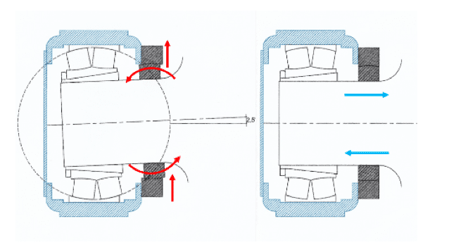

The Self-Aligning Pressurised Oil (SAPO®) Seal is a patented, engineered sealing solution that will accommodate misalignment requirements without compromising on sealing effectiveness. Furthermore, SAPO® Seals are fully maintainable, monitorable and predictable providing peace of mind to the end user.
In order to effectively maintain positive sealing, the SAPO® Seal is designed to float with respect to the housing as well as remain parallel with the shaft. This unique design allows for articulation to the allowable misalignment limits of spherical roller bearings.

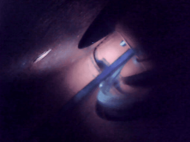

SAPO® Seals are fully maintainable, monitorable and predictable with state-of-the-art intra-bearing housing endoscopic monitoring via the SAPO® Scope. Maintenance personnel are able to visually monitor the housing cavity for contamination ingress and excessive bearing greasing whilst the machine is fully operational. This type of visual monitoring is truly unique in providing peace of mind and removes any doubt in regard to contamination ingress.

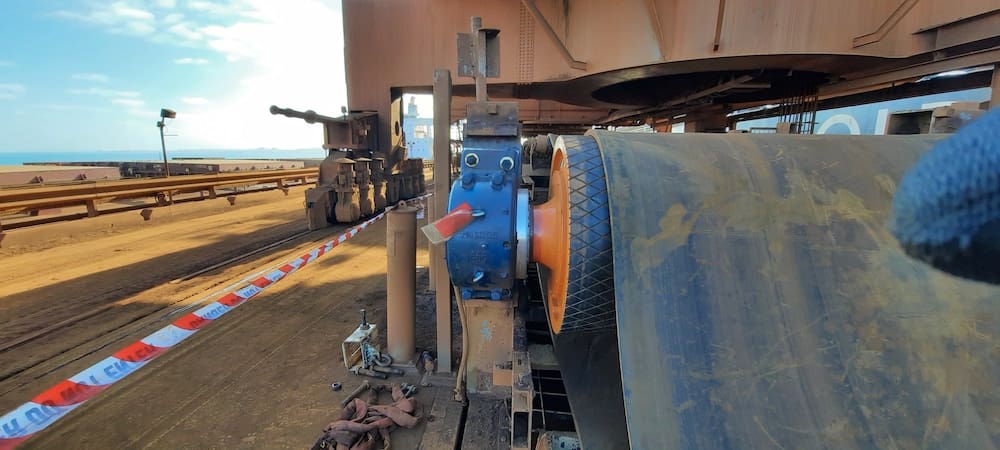

A large 2m diameter pulley weighing approximately 28 tonnes on a system conveying bulk material across the Pilbara was changed out every six months due to repeated rapid
contamination ingress related failures. The site team decided to make the switch to SAPO® Seals and have experienced reliability and predictability to another level.
Another critical pulley on a ship loader conveyor system was experiencing reliability issues that caused unplanned downtime costing hundreds of thousands of dollars. The pulley was fitted with SAPO® Seals at the next opportunity and has been operating reliably since the switch.
The implementation of SAPO® Seals required no modifications to standard ‘SD’ type bearing housings.
