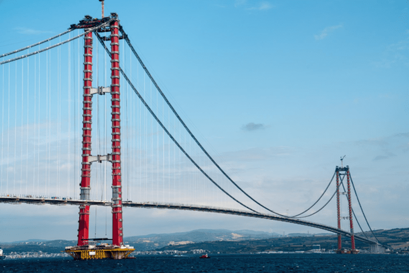

Bearings from SKF are playing a key role in a record-breaking engineering project – the world’s longest suspension bridge, which recently opened in Turkey.

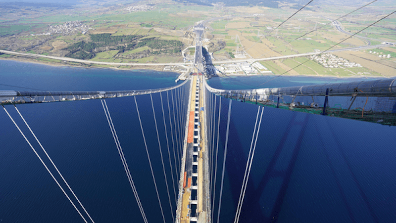

The 1915 Çanakkale Bridge spans a distance of more than 4 km across the Dardanelles strait in the north-west of the country. It forms part of a larger road construction project worth more than €3 billion.
