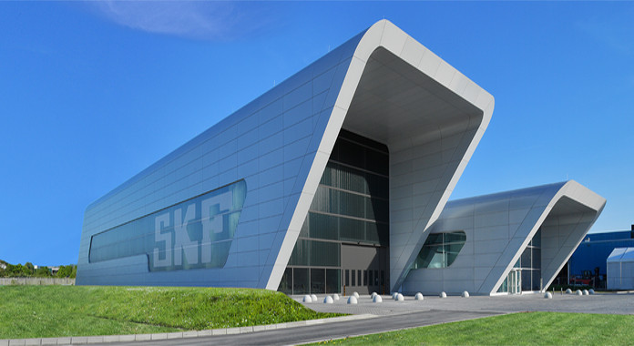

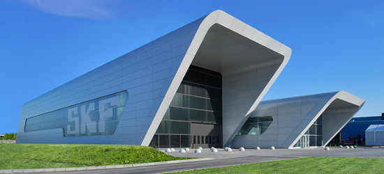

Unique large-size bearing test rigs provide real-life results
The Sven Wingquist Test Center is home to two gigantic rigs. They enable accurate testing methods that will support the proprietary improvements in large size bearing design.
