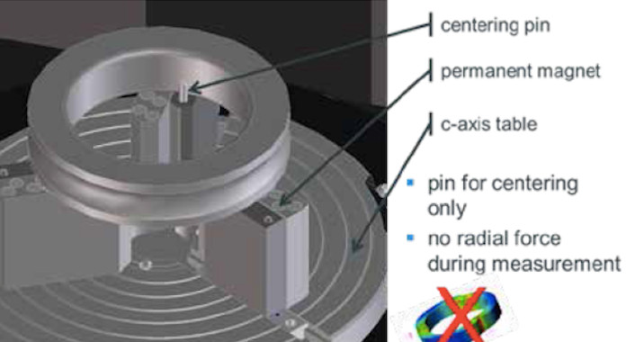

The rotary table, by itself has a radial run out of 0.2 μm only. Together with the Klingelnberg de-signed measuring head 3DNANOSCAN the capability to perform form tests is therefore fully guaranteed. An automatic three-jaw chuck offers controlled and low clamping forces. For very thin rings it can be equipped with magnets on the jaws to fix the part as shown in Figure 2. This allows high precision form testing with absolutely no influence of the clamping on the measuring results.
