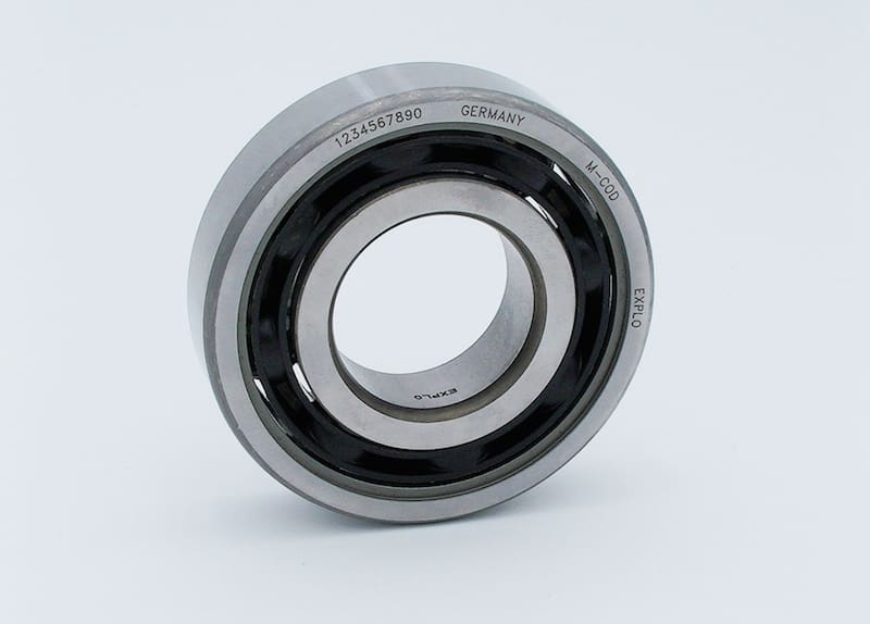

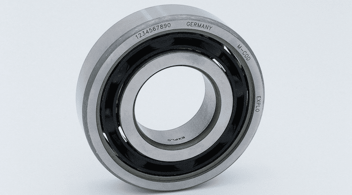

The marking type is also different. The bearings are marked with a variety of information, ranging from alphanumeric production codes or product data (site or date of manufacture) to Datamatrix codes or logos. The inscriptions must be clear, readable and unalterable. This last point is especially true if the bearings are subject to significant mechanical or thermal stress.

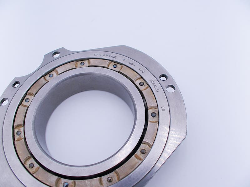

In addition to their great modularity, the marking solutions used must be able to adapt to the different parts’ shapes. Consisting, among other things, of an outer and inner ring, it is common to engrave both. This involves flat, circular, concave and convex markings. All of this while considering cycle times that can sometimes be in the order of a second.

The laser marking specialist had the opportunity to prove the qualities of its solutions by taking up the challenges proposed by a major Swedish ball bearing manufacturer with a presence in Germany. The manufacturer wanted to mark an alphanumeric and Datamatrix code on steel bearings with diameters ranging from 150 to 600mm. In addition to adapting to the different part sizes, the solution had to be integrated directly into the production line and be able to mark the bearings in two places at the same time, while ensuring that the Datamatrix was read back.
With its many years of experience, SIC MARKING was able to offer a customised station, equipped with an IPG 50W laser, marking on the bearing face and an IPG 3D laser, automatically controlled on 2 axes, capable of marking on the part radius. A proofreading system was also integrated in order to proofread the marking directly, as well as a conveyor belt, allowing the machine to be integrated into the production line.
