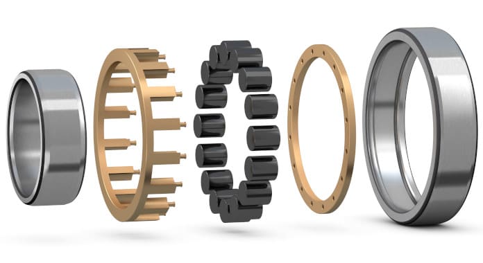

Hybrid bearings, which combine hardened steel rings with rolling elements made of high-performance ceramic materials, are an increasingly popular option for demanding applications. Bearings of this type can outperform conventional designs where high speeds, high temperatures or poor lubrication conditions are experienced.
Those characteristics have led to their use in jet engines and other critical aerospace equipment. Hybrid bearings also provide high levels of electrical resistance, making them useful in applications, such as electric motors and generators, where stray currents can damage steel bearing surfaces.
Ceramic materials have many characteristics that make them ideal for bearing applications. Modern ceramics such as silicon nitride are hard, light and can be manufactured with an extremely smooth surface finish. Ceramic materials do have disadvantages, however. Despite continued efforts to improve their toughness, these materials can have issues with damage tolerance in the form of sensitivity to imperfections that may pre-exist in the material or on the surface, which will potentially endanger the integrity of the ceramic rolling elements used in hybrid bearings.
