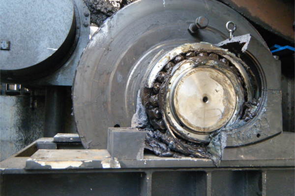

Lubrication of rolling element bearings is one of the most misunderstood and abused tasks in industry. Can it be true that 40% of bearings never live to their engineered life cycle and that bad lubrication practices are the leading cause of this mortality? Bearings depend on grease to reduce friction levels. By avoiding three common mistakes when greasing bearings you can predict the right time to grease, know how much grease to apply, and be confident in the bearing’s overall health.

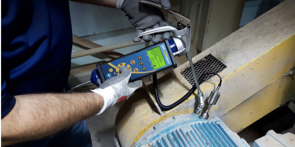

How do we know when just the right amount of grease has been added? By monitoring the friction level with ultrasound as new grease is applied… slowly, one shot at a time. Listen to the bearing and measure the drop in friction as the grease flows in to the bearing. As the decibel level approaches a minimum value and stabilizes pay close attention. Add single shots. Should the decibel level begin to increase slightly, stop! The job is done.

Like any job there is a right way and a wrong way to do things. Simply listening to a bearing with an ultrasound device that gives no measurement feedback is a recipe for disaster. The audible feedback alone is too subjective to draw any comparative conclusions. No two people hear the same and there is no way to remember what the bearing sounded like a month ago.
The third mistake is depending solely on subjective ultrasound noise when precise quantifiable data is available. Therefore always use an ultrasound instrument with digital decibel metering. Better still, use a device that provides multiple condition indicators. Max RMS and Peak dB measurements indicate alarm levels and greasing intervals while Ultrasonic Crest Factor provides insight about the bearing condition in relation to its lubricant. Crest Factor helps us differentiate between bearings that need grease and bearings that need to be replaced.

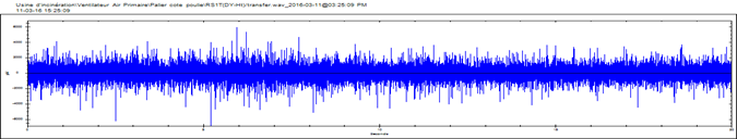

Before greasing

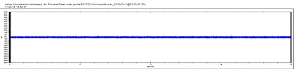

After greasing
When the ideal lubrication level is reached, the dB microvolts value returns to its normal level. This is perfectly audible in the headphones, in the reproduction of the dynamic signal and visible on the screen of the SDT device.
