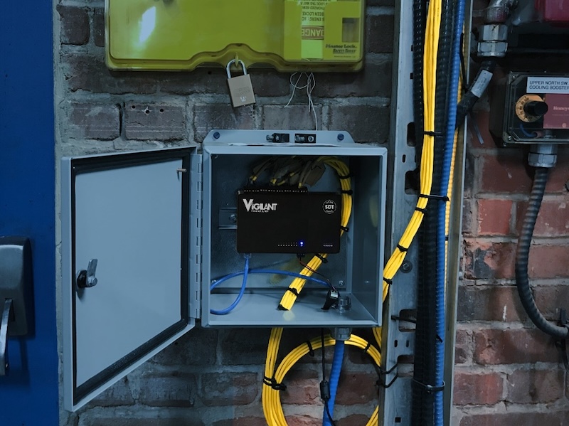

Vigilant is a fully integrated, real-time monitoring system designed for continuous condition assessment of rotating assets like motors. It uses a combination of ultrasound and vibration technologies to capture a full picture of motor health. The system includes eight dynamic channels for high-frequency acoustic and vibration data, along with four static channels for additional sensors such as temperature, tachometers, or process indicators. Vigilant’s embedded software analyzes and trends these signals, providing early warnings for conditions that could lead to energy inefficiency or catastrophic failure.
By installing Vigilant, factories can identify problems such as increasing friction in bearings due to lubrication breakdown, minor shaft misalignments that raise vibration and energy draw, or resonance conditions that may lead to fatigue. These issues are often invisible to the naked eye or even to basic monitoring tools, but they manifest clearly in the ultrasonic and vibration signatures that Vigilant captures and interprets. More importantly, Vigilant operates autonomously, continuously collecting data and integrating with existing SCADA, CMMS, and digital platforms via open protocols like OPC and HTTP.
