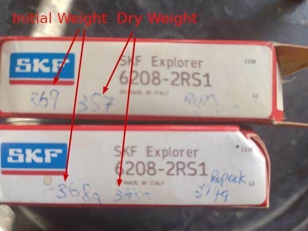

On two occasions 3Phi Reliability has gently opened Newly purchased Sealed Bearings from an OEM supplier. These bearings were weighed initially and then reweighed once Ultrasonic cleaned removing all traces of the original grease.
The Results
One has 12grams, and the other 5 grams.
What this means is Grease Service Factor proportional to Grease Charge can vary by more than 200%, therefore the variability in Bearing Life is greatly determined by manufacture.
It appears in both these occasions the Initial Total weights are within a gram (Resolution of the scale) suggesting the grease fill is controlled to a total weight, irrespective of the Dry bearing weight.
Grease depletion is proportional to the initial Grease charge therefore it’s impossible to conduct a Time based replacement program with any accuracy.

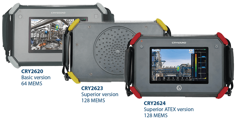

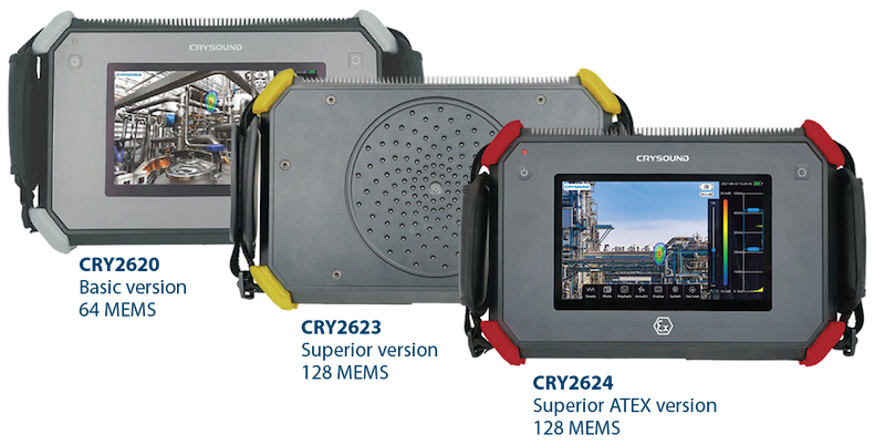

An acoustic camera can be used to identify lubrication defects but the difficulty arises in Controlled Data collection and getting consistant on regular collection points. This strategy requires a trend to be established. Acoustic camera will identify gross problems and may be worthwhile to get into control quickly. It is recommended to hire or have an initial survey with a camera.

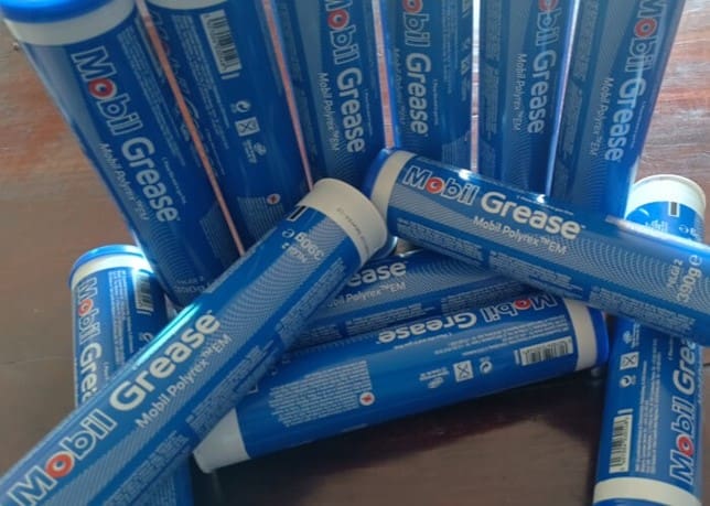

The reason 3Phi Reliability cleaned those bearing was to repack them with a Poly-urea based thickener in an application of high moisture. The grease used was Mobil Polyrex EM.
Poly-urea based thickeners can be incompatible with other greases so Sealed Bearings are an ideal application as greases can not be mixed.

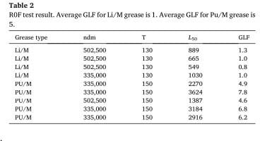

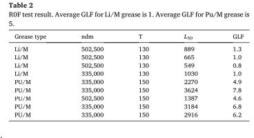

A trail at a dairy plant showed using Poly-urea thickeners over Standard lithium thickeners outlasted by a factor of at least five times. This has a massive impact on the total cost of ownership.
The strategy of on condition replacement plus changing thickener type is proven return Reliability and Cost savings and is part of 3Phi Reliability Best Practice Motor Management.

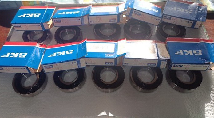

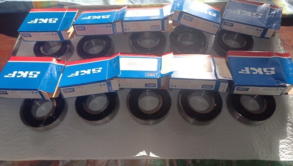

Our Bearing Vendor organized for the repacking of Sealed Bearings as the lead time to source Poly- urea thickener was in excess of 12 months.
Chula Jayawardene Manager (Motion Industries) had bearings repacked for our facilities and those were named “MGC Specials”. The MGC Specials were then restocked into the maintenance stores as a standard SKU.
Li/M is the Lithium based Thickener, and in comparison the PU/M is the Poly-urea based thickener showing a GLF (Grease Service Factor) significantly higher with an average well above x5.
Cite Paper. The Grease Life Factor concept for ball bearings
