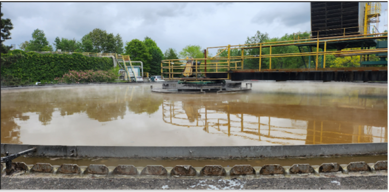

This large wastewater decanter centrifuge is tasked with continuously separating solid materials from liquids at a Canadian Pulp & Paper Mill.
Enormous quantities of water are used in the pulp and paper manufacturing process. For the process to be successful, fibres, such as pulp, wood, wood chips, and recycled paper must be suspended in water. In doing so, large amounts of wastewater is created. This wastewater must then be recovered so it can be reused in the future. Part of the wastewater recovery process involves using a Wastewater Decanter Centrifuge.
The Wastewater Decanter Centrifuge turns extremely slowly. The Bull Gear takes about 10 minutes for it to complete one full rotation, the pinion rotates at 2.95 RPM.

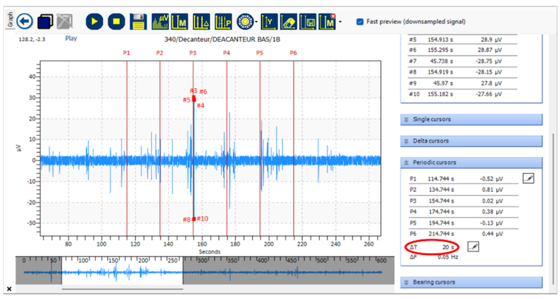

When monitoring this asset, the SDT Ultrasound Solutions Partnered Ultrasound Services Team chooses to take readings with the #SDT340, as it is capable of taking 10 minute readings, which are necessary to capture one full rotation of this assets bull gear.
The 10 minute time waveform recording can be observed below in Figure 1.

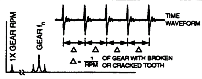

Observed in Figure 1, we can see a similar pattern to that in Figure 2. There is a pronounced spike every time the problem tooth tries to mesh with the teeth of the bull gear. The time between impacts corresponds to 1/RPM of the gear with the tooth problem. This data analysis lead SDT’s Reliability Technicians to believe there is a cracked/broken tooth on the pinion gear.

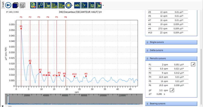

As observed in the pinion’s FFT, it can be seen that high levels of ultrasound above the sound floor are appearing at 1 X RPM.
Take into account that the resolution shows us a Delta F of 3.5 RPM. This number is not accurate as recordings were taken with too low of a measurement resolution. The real speed of the pinion is 2.95 RPM as shown in calculations earlier.
