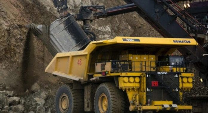

  1. Tightness testing of the air intake systems of the large diesel engines in haul trucks using ultrasound has saved one mining Company alone over €14M in three years for an investment of less than €28,000. Additional operational savings have been seen by minimising the time spent ensuring that the drivers’ cab environments are dust-free.
