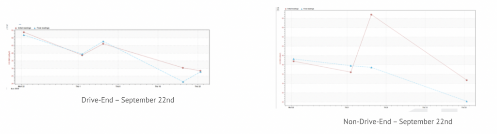

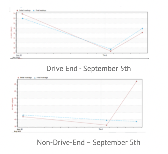

Previously, the lubrication team greased their bearings on a time-based schedule. The calendar schedule called for 50 grams of grease every two weeks, regardless of the needs of the bearing.
Since switching to the ultrasonic condition-based method for greasing their bearings based, Torki and his fellow lubrication technicians noticed a steep decline in grease consumed. It used to be 50 grams every two weeks for both the drive-end & non-drive-end bearings, it dropped to 16 grams for the drive-end and 14.4 grams for the non-drive-end during the most recent successful lubrication task, which can be seen in the following two figures.

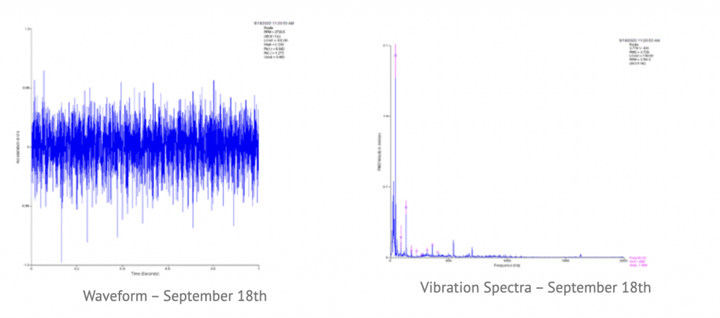

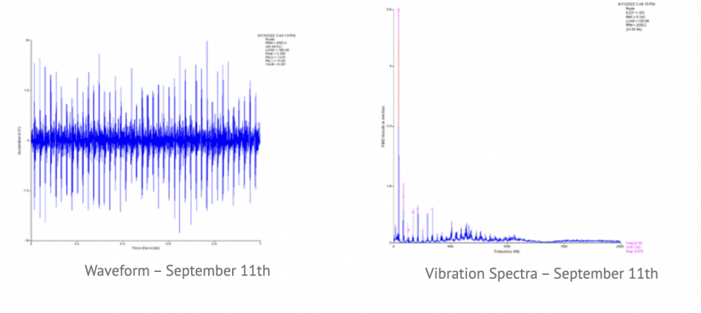

As seen in the vibration data, the bearings were in a failed state due to mechanical looseness and required replacement. They were replaced during the next shutdown, and new vibration measurements were taken on the machine. As seen below, the overall RMS went from 8.2 to 2.7 after the bearings were replaced.
