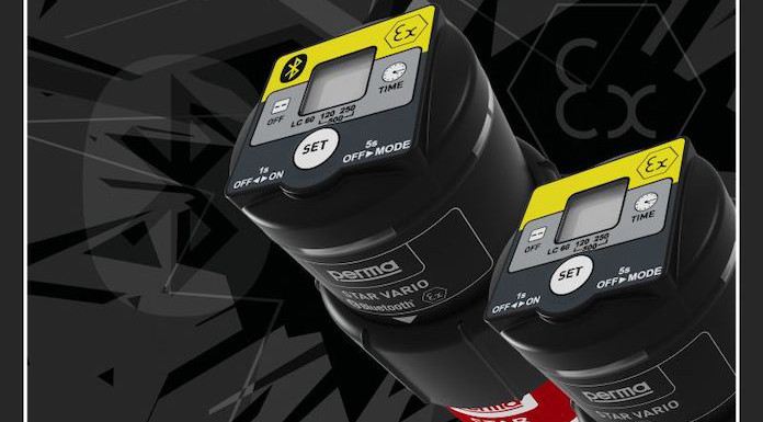

The new perma STAR VARIO EX is an electromechanically driven single point lubrication system, enhanced with an additional feature: the certification for use in potentially explosive areas with gases (up to Zone 0 / Div 1) and dusts (up to Zone 20 / Div 1).
The new product is based on a further development of the tried and tested perma STAR VARIO high- quality lubrication system. As such, the perma STAR VARIO EX now enables the extremely precise automatic lubrication perma products are known for, even in hazardous environments.
The lubrication of roller and sliding bearings, sliding guides, open gears, gear racks, spindles, shaft seals and chains are characteristic fields of application for the new perma STAR VARIO EX. Thanks to its precise lubricant metering, the perma STAR VARIO EX is perfectly suited for electric motors with exact lubrication instructions. As a positive side effect, the lubrication point is simultaneously sealed against the ingress of solid or liquid contaminants.

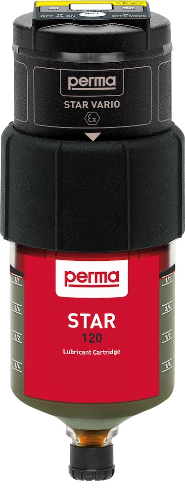

The perma STAR VARIO EX consists of an electromechanical drive, a lubricant cartridge, called STAR LC, and the Battery pack STAR VARIO EX.
The lubrication system operates independently of temperature and pressure during the production process in a temperature range from -40 °C to +60 °C. With adjustable discharge time settings (monthly or weekly intervals) and four different sized STAR LC units (60, 120, 250 or 500 cm3), it is possible to respond to individual requirements of the lubrication point.
The drive is reusable. All the settings can be adjusted at any time via the LCD display. The operation is quick and self-explanatory using the button on the control panel. Thanks to the intrinsically safe Battery pack STAR VARIO EX, both battery pack and STAR LC can be
replaced directly on site.
