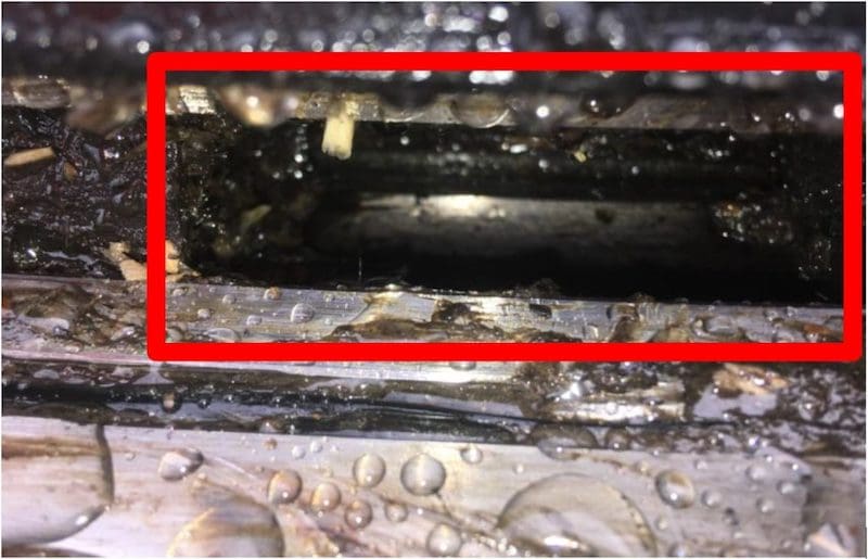

After extensive work, the team was able to determine that some equipment was missing a number of rolling elements essential to its proper functioning. The missing rolling elements were probably due to wear of the “spacers” between the balls acting as cages.
