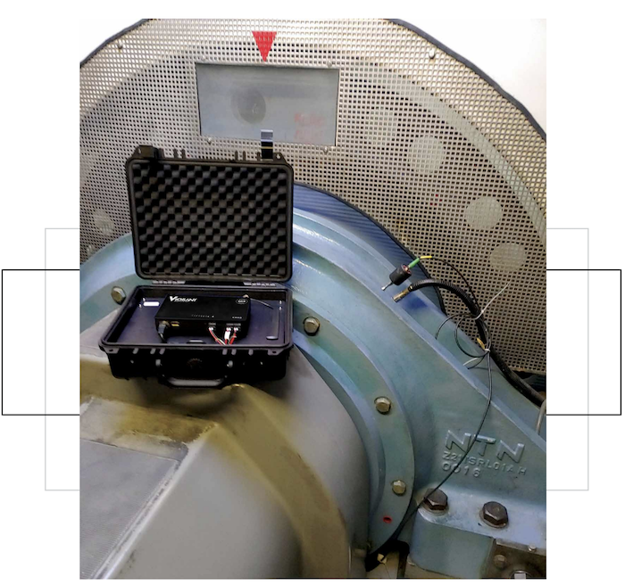

+ Vigilant supports up to eight sensor inputs, continuously collecting data from critical points such as the main bearing, gearbox planetary bearings, and generator bearings. The system detects anomalies like friction, impacting, or turbulence, which indicate potential failures.
+ Equipped with Wi-Fi, Ethernet, or cellular connectivity, Vigilant transmits live data to a central platform. Maintenance teams can access this data remotely, reducing the need for on-site interventions and enabling quicker responses.

    Ultrasound technology is particularly effective for slow-speed components like the main bearing. By detecting subtle changes in friction or impact levels, Vigilant provides early warnings of potential failures. For instance, in a recent installation, Vigilant identified an outer race defect in a slow-speed bearing that traditional methods missed, allowing technicians to address the issue before it escalated.

In a notable deployment, Vigilant was installed on a 90-meter wind turbine in a remote location. The system continuously monitored seven critical points, including the slow-speed main bearing and gearbox bearings. Within days, Vigilant detected a lubrication issue in the main bearing and an impending failure in a planetary bearing. These insights allowed the maintenance team to address the problems proactively, avoiding costly downtime and repairs.
