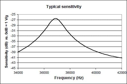

Ultrasound contact sensors are resonant sensors. Their sensitivity is an important point, but not the only one. The basis of Condition Monitoring is to trend data and to perform a corrective action when an alarm is triggered. If you have no guarantee that two sensors provide a similar result for the same signal, then change supplier. Your historical data and alarm thresholds will become useless when replacing a defective sensor!
Therefore, as for all technologies, the transducer characteristics: the sensitivity and the resonant frequency; must be clearly specified and certified by the manufacturer. In fact, SDT is in a position to provide such guarantees because we are able to offer customers sensors with standardized measurement reception quality.

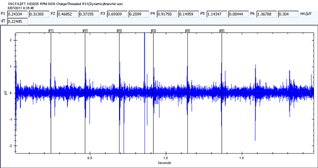

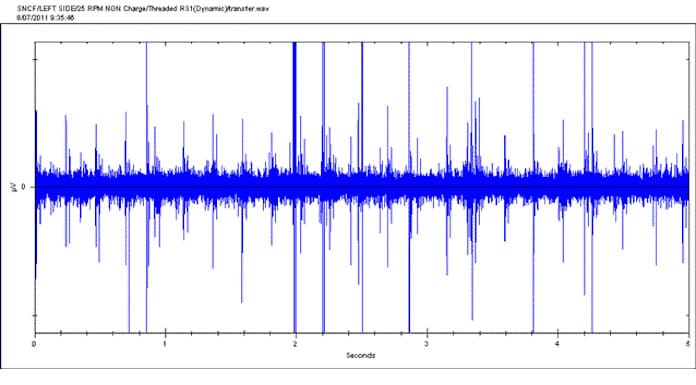

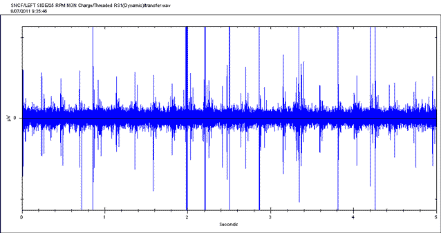

Here is the time domain comparison coming from machinery running at 25 rpm, using an acquisition time of 5 seconds.
Note: the same vertical scale has been used for the two time signals above.
The duration between impacts corresponds to the Ball Pass Frequency Outer race (BPFO). The diagnosis is that the bearing will have some damage on the outer race.
The diagnosis is outer race damage on this bearing.
